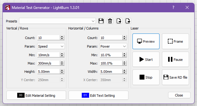

  2. Open LightBurn, go to the top toolbar, click Laser Tools and select Material Test. Use the default settings or adjust them to your liking.
Note
Some lasers won't fire under 15% power — change the minimum value in the test accordingly.
LightBurn Material Test settings

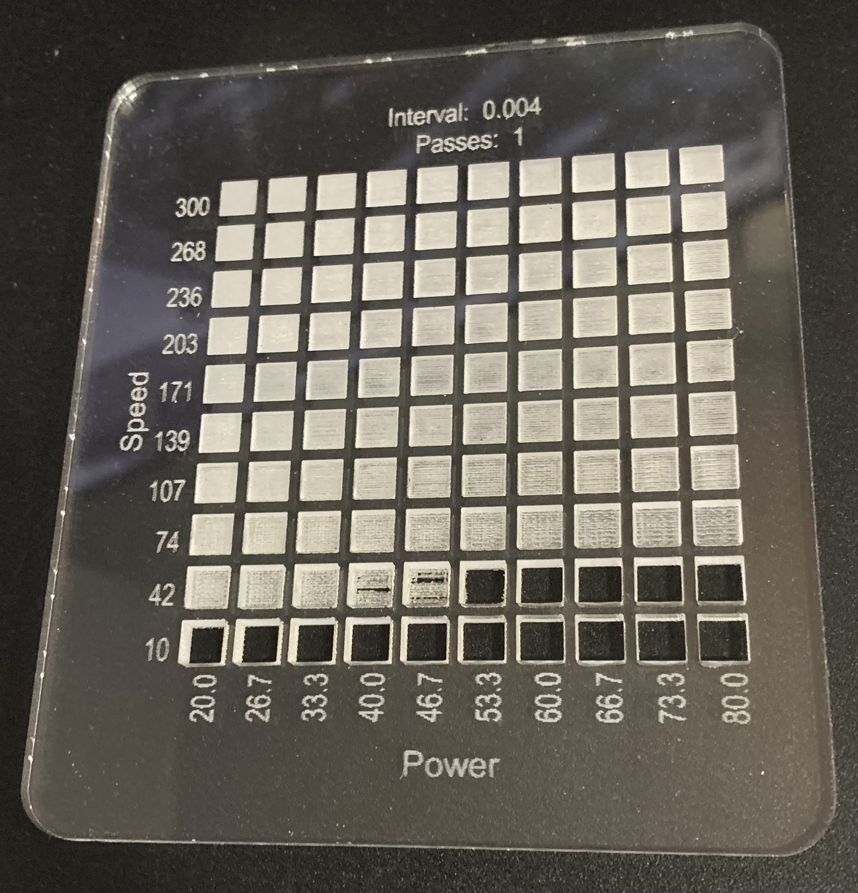

Once the test finishes you'll have a reference swatch to use as a guide in the future.
Completed material test swatch

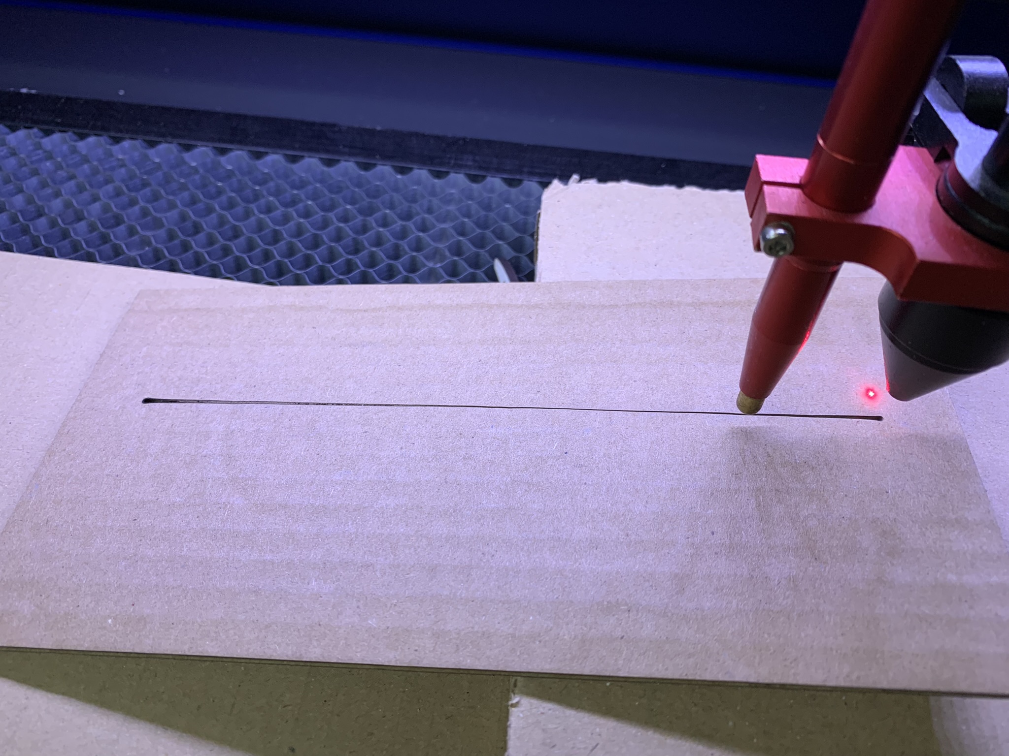

Performing a Ramp Test to Find Focal Distance
For precise, consistent results you need to find the focal distance — the distance between the laser lens and the surface of the material. It has a big impact on engraving and cutting quality. A ramp test engraves a line across an angled piece of material so you can see exactly where the beam is sharpest.

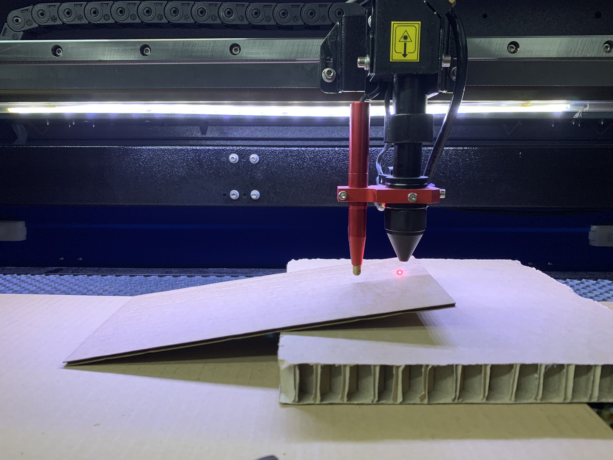

  1. Prepare the material. Use a scrap strip as wide as your laser bed. Place it across the bed and put a block under one end to raise it approximately 2"–3".
    Ramp test material propped at an angle

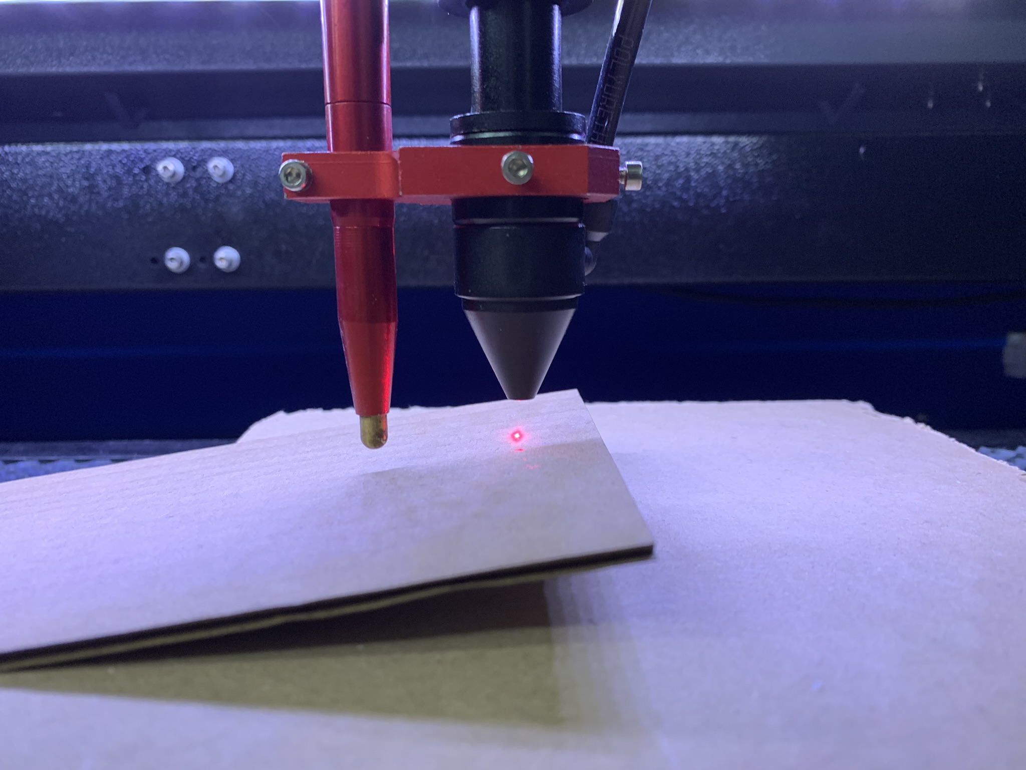

  2. Position the laser head a few mm above the highest point of the ramp.
    Positioning the laser head above the ramp
  3. Set up the test. In your laser software create a single line the width of your material. Set the laser to 50% power and 200 mm/s.

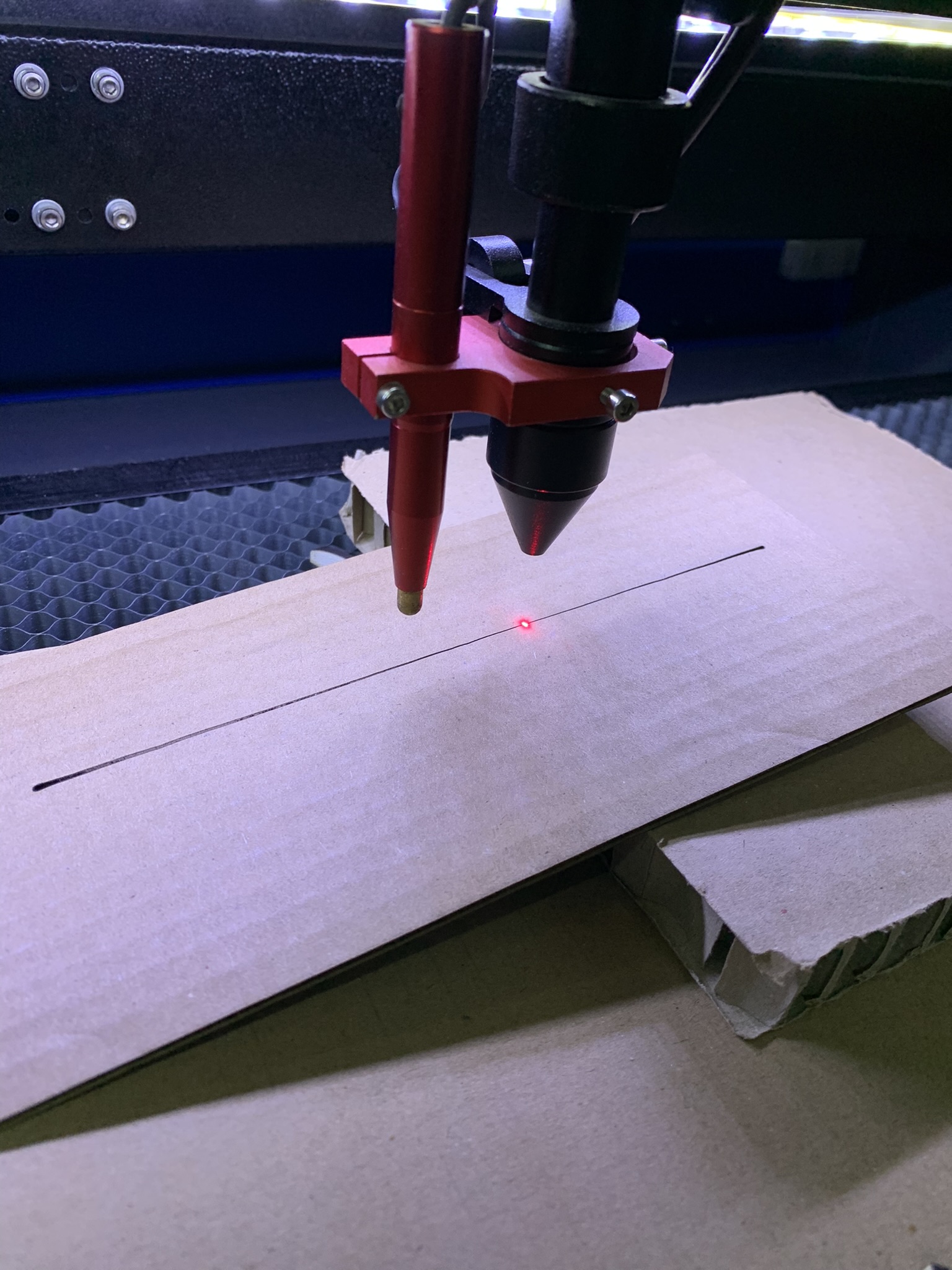

  4. Run the test. Frame it first, then send it to the laser.
  5. Observe the results (find the focal point). Watch how the engraving quality changes across the ramp. The point where the line is finest and sharpest is your focal point.
    Ramp test result showing the sharpest point

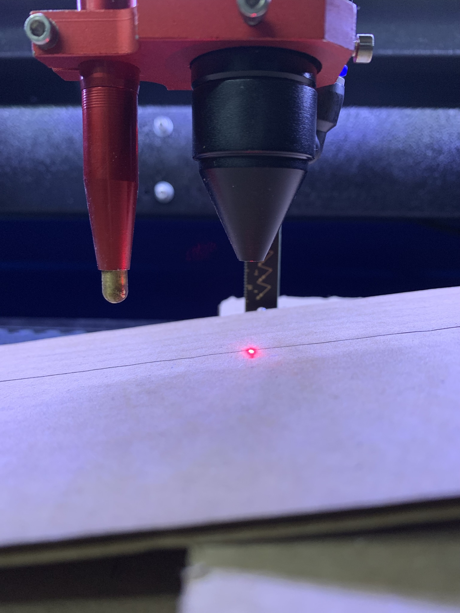

  6. Measure the focal distance. Position the laser head directly above the focal point as closely as you can without moving the material — this is your focal distance. Record it for future reference. If your laser has a red-dot pointer, you can now align it to the focal point for accurate cuts and engravings.
    Measuring the focal distance
    Using a red dot pointer at the focal point
