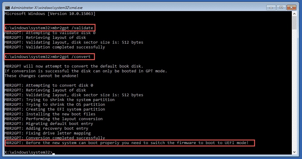

Step 2: Validate the Conversion
In the Command Prompt, type the following command and press Enter:
mbr2gpt /validate /allowFullOS
This performs a validation to check if your system can be converted without issues.
Note
If validation fails, the usual causes are: more than 3 primary partitions on the disk, BitLocker enabled (suspend it first), or the disk isn't the system disk. The tool won't touch anything until validation passes.
Step 3: Convert MBR to GPT
  1. If validation succeeded, run the conversion:
mbr2gpt /convert /allowFullOS
  1. Once the conversion completes, close the Command Prompt and restart your computer.
mbr2gpt conversion output
